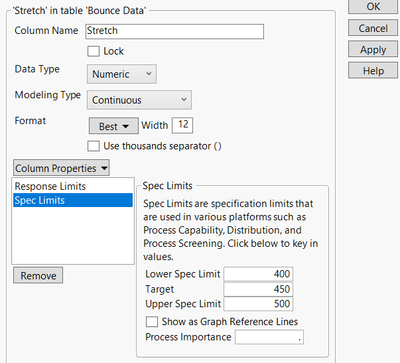

Using the Bounce Data dataset in the JMP sample library, I specified Spec limits on the response "Stretch" (LSL=400, Target=450, USL=500) :

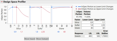

Then I create a model, and open the Design Space Profiler to find the correct factors ranges that help minimize the proportion of out-of-spec samples :
With these factors ranges, I can expect 97,74% of my samples to be in spec.

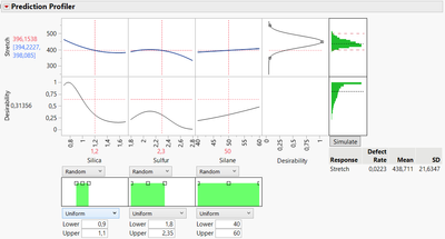

Opening now the Simulator, I specify these factors ranges using Uniform distributions (Distribution choice has an influence on the defect rate), and then clicking on "Simulate" :
I have now a Defect rate of 2,23%, so very close from what I could obtain from Design Space Profiler (P=100-Inspec=100-97,74=2,26%). Remember that the Simulator calculations are based on Monte-Carlo simulations, so Defect rate can vary a little bit at each simulation, but the result should be close to the Design Space Profiler. The two platforms are now aligned.

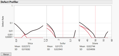

Finally, looking at the Defect Profiler, you should adjust the factors ranges of this profiler (right-click on X axis, and in "Axis Settings", specify the min and max values of your factors to match the Design Space Profiler's ranges) so that the defect rate are only calculated based on the same ranges of the Simulator and Design Space Profiler :
The max defect rate on this Profiler can be found at 2,27%, so quite close from the one found with the Simulator (2,23%) and from the Design Space Profiler (2,26%).
