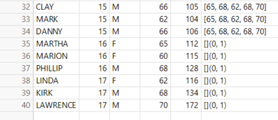

But it's not as easy as I expected ....
Hm, it's quite late - I don't have any idea why:
6 REPLIES 6

The next question - and therefore the title of the post:
why does JMP delete the entries when I close dtsum?

This also fixes the issue with several "0" entries in the previous approach.
So, under the line, the questions was not:
why does JMP delete the values in dt if table dtsum is closed?
the actual question was:
why does JMP use dtsum:height instead of dt:height when calculating entries for the data table dt?
open question: why does dt:height just fix the issue for set each value() and not for formula()
