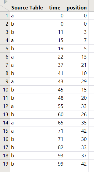

Suppose I have two lines, distance vs. time for two different moving objects.  The time measurements for object 1 and object 2 are at arbitrary times, i.e., the measured times for object 1 aren't the same times as provided for object 2.
Is there a way in Graph Builder to plot the *difference* between those curves vs. time?

Input data like this

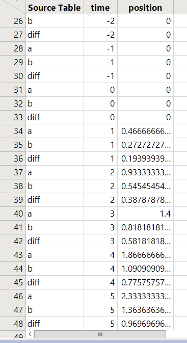

And the interpolated data like this

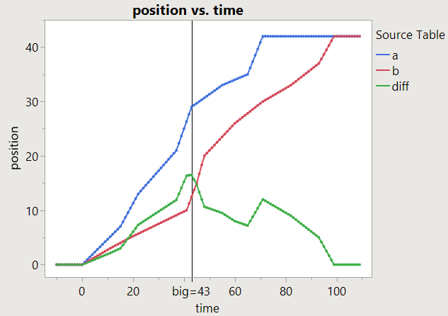

Producing a graph like this:
The green curve is blue - red; the ref line is at the first biggest difference.The green curve is blue - red; the ref line is at the first biggest difference.
If this was a race, a won in 71 seconds and b lost in 99 seconds. a was furthest ahead at 43 seconds (well, maybe. You can't be too sure about b's position at time 43 in the original data.)

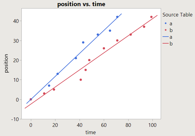

You can't get that from a simple linear fit on the original data:
Original data with linear fit.Original data with linear fit.

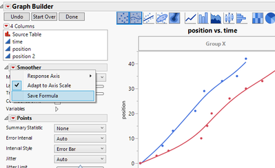

Here's a low scripting alternative using the Save Formula command available in the red triangle menu for a Smoother or Line of Fit element.
Starting with Craige's ab.jmp table using Overlay to get two lines/curves, use Save Formula to get a new column with a formula that looks like:
If( :Source Table == "a", Spline Eval( ... ), :Source Table == "b", Spline Eval( ... ), . ))
Go into the Formula Editor for the new column and change the formula to subtract the two Spline expressions:
Spline Eval( ... ) - Spline Eval( ... )
And use that as the Y in GB.

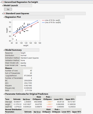

@Mark_Bailey If the two lines are linear, then a Fit Model of Height predicted by Weight, for the 2 sex groups end up having an term estimate of -2.079223.  Wouldn't that be the difference between the lines when simplified to a linear regression?
Jim
