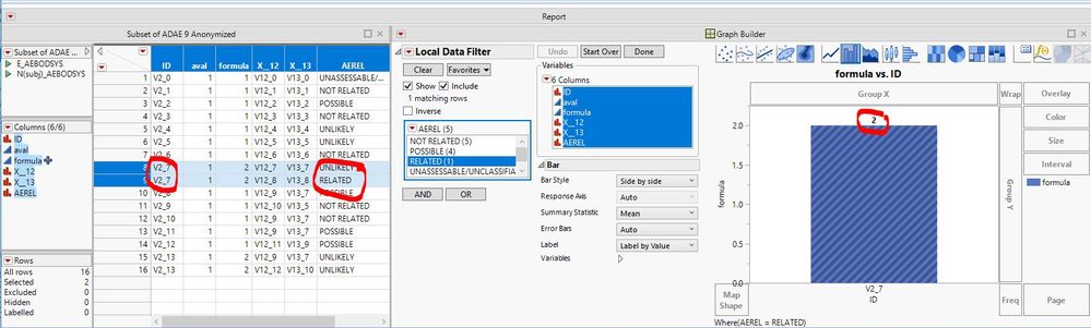

Dears,
Can anybody give a hint, if it is possible to re-evaluate a Formula for a report based on the subset on the data selected in Local Data Filter?
E.g. my formula is
Col Sum(:aval, :ID)
In the screenshot attached, only line9 meets the local data filter conditions. Is it possile to create a formula which would return 1 instead of 2 (since within ID= V2_7 only 1 record with aval = 1 would be summed)?
I would strongly prefer an intercative solution (without actually subsetting the table or creating summary table). I learned that the Col ... formulas can caluculate the statistics based on the "Selected()" Row state, therefore I suppose there could be a way of doing something similar based on the Local Data Filer subset.
Another solution which could partially meet my requirements would be availablility of N Categories(:var) Summary Statistic in the Graph Builder, but as far as I understand it's not available yet.
Thanks a lot!
Alex.

Hello, I face the same issue today and tried the solution of @txnelson. Unfortunately the formula is not updated when I use it with a local data filter. Did I miss something? Or is the solution not working anymore with JMP 16?

The formula in the data table doesn't know the selection of the Local Data Filter of your report.
More surprisingly, this is also true for a transform column in a report - it just ignores the selection of the local data filter of the respective report.
