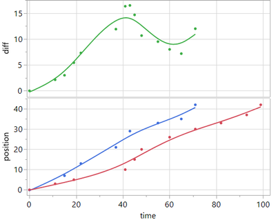

As a combination of the different suggestions, you could also use a simple interpolate() - interpolate() to calculate the difference and then use the lambda setting of the smoother plot to tune the granularity of the curve.
Open( "$DOWNLOADS/ab.jmp" );
New Column( "diff",
	Formula(
		rowsA = As Constant( Current Data Table() << get rows where( :Source Table == "a" ) );
		rowsB = As Constant( Current Data Table() << get rows where( :Source Table == "b" ) );
		xA = As Constant( :time[rowsA] );
		xB = As Constant( :time[rowsB] );
		posA = As Constant( :position[rowsA] );
		posB = As Constant( :position[rowsB] );
		If( Min( xA ) <= :time <= Max( xA ) & Min( xB ) <= :time <= Max( xB ),
			Interpolate( :time, xA, posA ) - Interpolate( :time, xB, posB ),
Graph Builder(
	Variables( X( :time ), Y( :diff ), Y( :position ), Overlay( :Source Table ) ),
	Elements( Position( 1, 1 ), Points( X, Y, Overlay( 0 ), Legend( 1 ) ), Smoother( X, Y, Overlay( 0 ), Lambda( 0.02 ) ) ),
	Elements( Position( 1, 2 ), Points( X, Y ), Smoother( X, Y ) )
