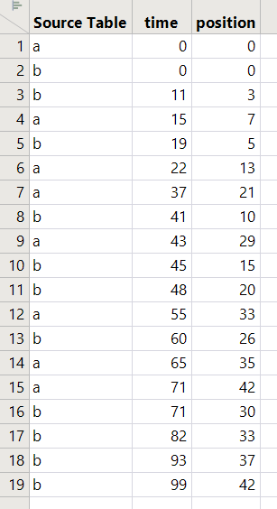

Input data like this

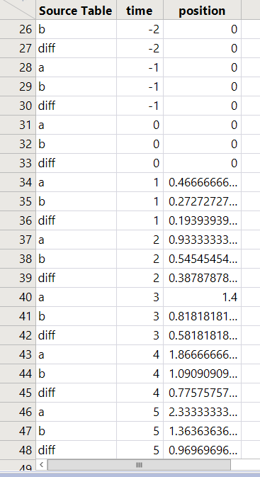

And the interpolated data like this
