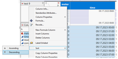

will make sure of that - but you have to sort the data accordingly:
With meter on the left, select the columns for meter and time and then:

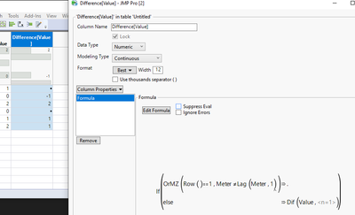

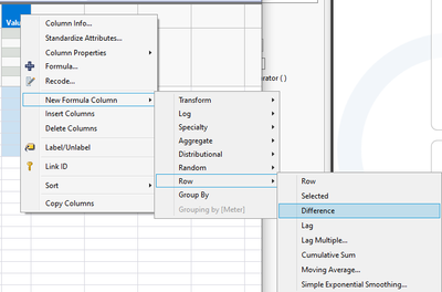

jthi
Re: Delta calculations
There is a way to do this interactively. Right click on your grouping column and make it Group By column for new formulas (data must be sorted by groups and most likely by time or something similar)
Next right click on your calculation/value column and go to Row->Difference
With this you get a formula like
-Jarmo
