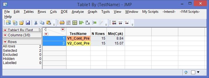

I got this script to get me closer but final table still missing other data from other columns, Split, Mean, Sigma, Min, Median, Max
dt = current data table();
dt << Summary( Group( :T
Untitled.jpgestName), Min( :Cpk ));
Re: Delete rows based on 2 conditions
sorry code was cut by image
dt << Summary( Group( :TestName), Min( :Cpk ));
