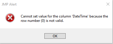

Hello Craige, I have tried that but seem to be getting errors when trying to use it:
I may be understanding it incorrectly as I am attempting to create a new column with the data:

Re: Delete Character from String In specific position
Could be just some simple mistake with column references.
