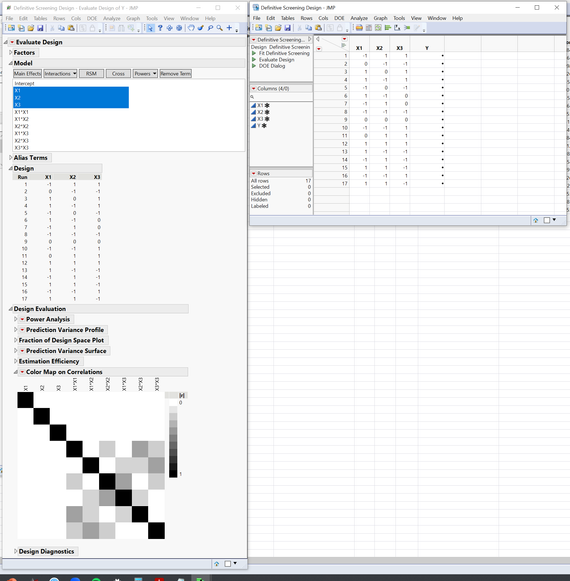

Regarding the last point about DSD projecting into a smaller matrix with no correlation between any estimates for any n factors, I am having trouble understanding this.
I created a 17-run DSD and tried fitting it to only 3 factors. However, when I evaluate this design I see that there is still correlation between the second order parameters. Are you saying that there should be a subset with which there is absolutely no correlation between even 2nd order parameters?

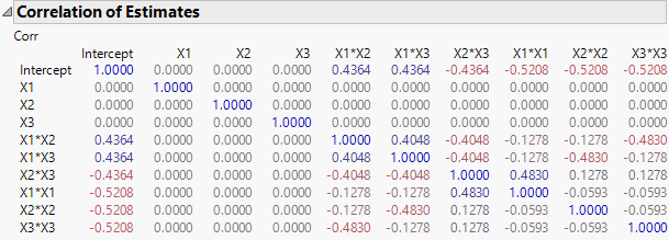

I also created an example of a DSD for this discussion. I added six continuous factors to the design. I simulated the response in which only the parameters for the main effects of X1, X2, and X3 were not 0 to satisfy the condition for the claim. I initially used Fit Definitive Screening to select a model. I clicked Run Model. I clicked Edit under Effect Summary to add all interaction and quadratic terms. Here are the correlations among the estimates:

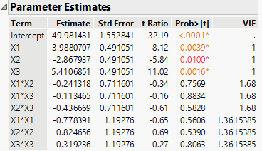

These correlations agree with your finding. All of this information depends only on the design and model matrices, not the response values. Regarding the claim in the documentation, I right-clicked on the Parameter Estimates and selected Columns > VIF:
The low VIF values, which do not depend on the response values, indicate that the correlations should have a small impact on the estimate precision.
