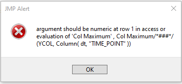

I encountered an odd behavior in a simple JSL script I am developing. In the script snippet below, the "By Var" column is not recognized as valid (see error message below). I confirmed that the simpler formula "max_y = col maximum (YCOL)" works fine. Hence, I believe that the issue is with the "By Var" portion of the formula.

			max_y = col maximum (YCOL, column (dt, "TIME_POINT"));

For some reason, when using the Col Maximum with a "By Var", I needed to specify that the column is a reference to a column
max_y = col maximum (as column (YCOL), column (dt, "TIME_POINT"))
