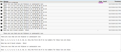

So to the table generated by jump I copied/past 20 times each line of the experiment that corresponds to each replicate. But then when I try to Fit my DSD, JMP gives me an error that when I look to the log it says: "there are runs that are not foldover or centerpoint tuns" (see image).

Nothing is wrong with what you did, but you can no longer use Fit Definitive. It requires a fold-over structure. Your replicates destroyed that structure. You can still use Fit Mode to specify the terms and any fitting personality available in the launch dialog to analyze the data and select a model.
