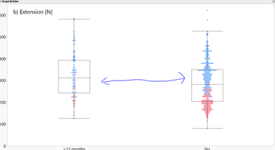

Hi everyone,
I wonder if there is a way to decrease the space between boxes in a box plot. I do not have groups, so I cannot use graph spacing. And when I try to change it manually by X-axis setting, the white space for the graph increases, which is not good. would you please advise how to proceed? Thanks

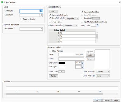

Re: Decreasing the space between boxes in a simple box plot
Those x-axis values you have are really "numbers" in the x-axis starting from 0
So you have some options which you can play around with:
  • Modify width proportion
  • Change graph size
  • Change X-axis ends
Combine these different methods together to hopefully get what you want.

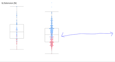

Thanks Jarmo,
In the x axis I have two group 1(with injury) and 2( without injury) these two
  • Change graph size
  • Change X-axis ends   works better.
