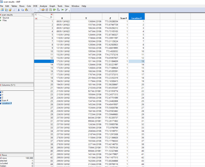

Hi,
I have a table with different scan results.
I have 180 scans with 1000 results per scan.
results are at the Z column.
I want to create a new column with relative scan results, meaning the results of scan 2 - the results of scan 1, results of scan 3 - the results of scan 2, and so on.
subtraction of results must be by Location number, 1-1, 2-2, 3-3, and so on.
I've tried to transpose the data but got lost in the way.

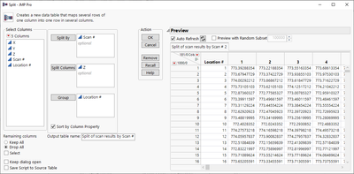

You could first split your data
Perform the calculations in the split data, stack it and then join/update it back to your original data.
