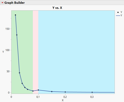

My data can be usually matched with an exponential decay function, however at some point on the curve where there is a rapid spike, then decay continues, therefore how can this sharp edge be fitted inside the exponential function?

  1. You could use the Nonlinear Regression platform and define piecewise functions if the profile/curve pattern always happen at defined x values/regions :
    • From X=0 to 0,08 : exponential function
    • From X=0,08 to 0,1 : linear function
    • From X=0,1 to 15 : exponential function

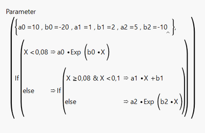

      You have to create parameters for the different regions of your curves (with random initial values) and specify the equations for each part of your curve thanks to the created parameters :

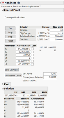

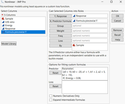

      Since there is only one curve, I fixed the X values, but you could also add Xi parameters if the pattern is the same but happens for different ranges of X values. Using the platform Nonlinear, you can then use your formula as "X, Predictor Formula" and your measured Y as "Y, Response". Launching the platform and click on Go so that JMP determines the parameters in your piecewise equation :
      Victor_G_1-1717707598008.pngThis method is flexible, but require good equations and ranges identification, and represent strong assumptions on the patterns in your curve and their generalization/repetition across all measured curves.

Even if there are analytical solutions to your problem in JMP, I would like to endorse the message from @statman about the "significance" of this peak in your curve. Is this really an important and practically significant pattern you have to keep in the analysis ? From a statistical point of view, there are no big differences in terms of model Sum of Squares Error (SSE) between the piecewise function (SSE=237) and the approximation by a "simple" exponential function with "Fit Curve" platform (SSE=287).

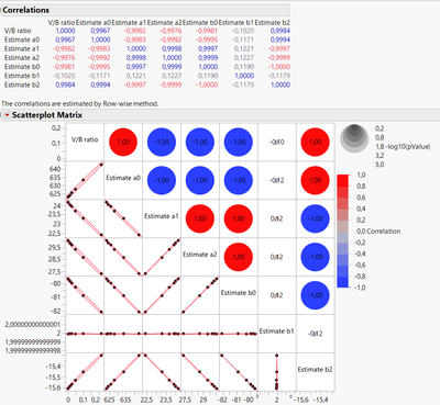

If you have identified the samples in your datatable, you can use the Nonlinear platform and use your sample ID in the "By" variable to fit the piecewise equation to each sample independently. You can press CTRL + click on "Go" to launch the estimation of parameters for all samples independently and simultaneously.
Then you can aggregate the parameters values (right-click in the panel "Solution" on the table with the parameters estimates, and click on "Make Combined Data Table"), compare them, and link/analyze them vs. your factor variable (for example by updating the generated table with the V/B ratio, splitting the data table by parameters and analyzing the correlations between the parameters values and the V/B ratio) :
