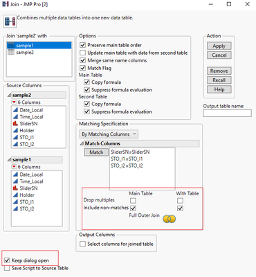

What sort of table do you want to end up with? The data from second table could have lost because there is nothing to match the table 1 with and you are using left join.
Try playing around with different types of include-non-matches options with enable match flag enabled. Also you can enable Keep Dialog Open to prevent modal from closing after pressing Apply. Makes it easier to test different options.

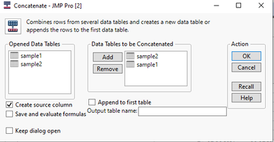

You could also try concatenating the data because you have same columns
