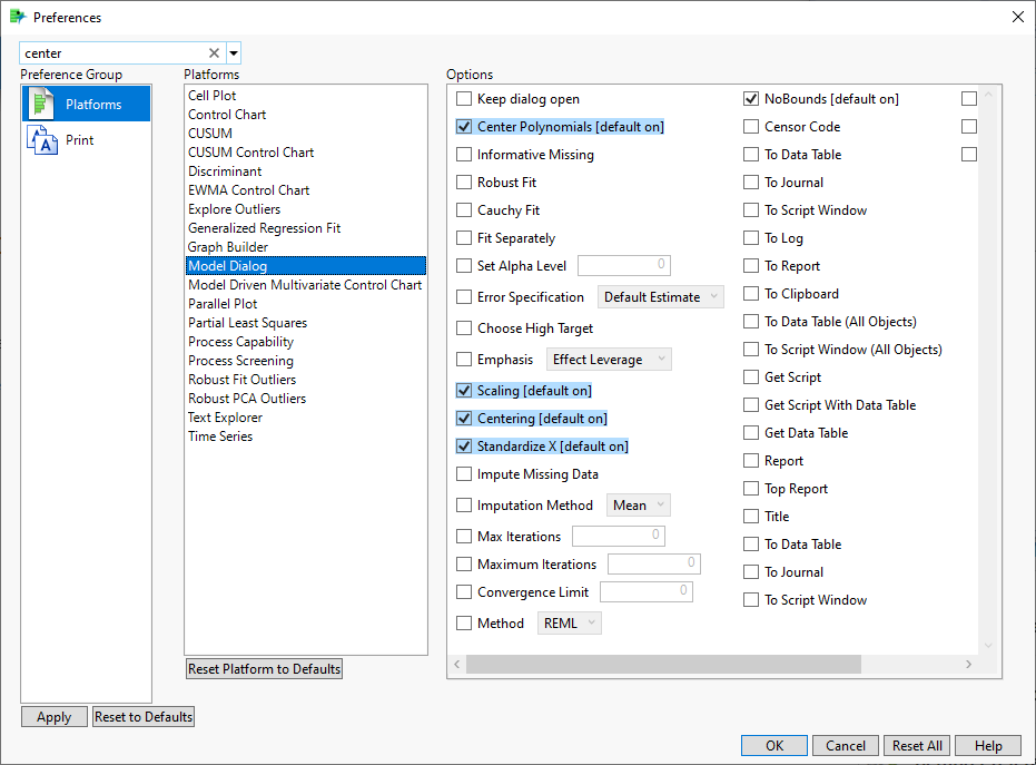

Can Polynomial fit preference be set for not centered?
Hi,
The standard polynomial fit returns a centered set of fitted parameters.  I get from a statisticians perspective why this is done, though in most of science and engineering this is not the default  way of looking at equations.  I know I can work around this by going to fit special selection, and click, click, click, click...
Is there a way to set the default behavior of polynomial fitting to use non-centered parameters?  I have looked an preferences but nothing is jumping (small pun) at me.

I found this preference:

Thank you Mark,
Given the extremely large range of preference settings, if would have taken me quite a while to find it.
Andy
Re: Can Polynomial fit preference be set for not centered?
Notice the Filter box in the upper left corner? It's your friend. Good to remember in the future!
