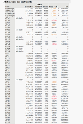

For model analysis, I used a second-degree model. I expected it not to work with so few experiments for so many coefficients, but for certain properties, it did work.
I'll illustrate with 2 properties.

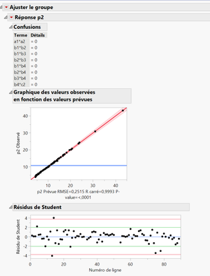

For p2, the fit works well; I have a model that fits both observation and prediction.
For p4, the fit works well in observation, but I have huge standard deviation and the prediction performs poorly with a press R-squared < 0.
Would you have any feedback or suggestions for improving the quality of my model?

And to add to @statman's questions, how many overall runs were conducted? Why would you put a1*a2 in the model when you never had a1 and a2 in the same blend? Is JMP even analyzing this as a mixture? I'm not sure it is, but you need to check by looking at the Analysis of Variance table and seeing the message: Tested against reduced model Y=mean. The model for p2 might look good, but it is clearly an overspecified model, so you are likely overfitting. That means the model would not predict future observations very well. Anytime your parameter estimates contain the words "Zeroed" and "Biased", JMP is automatically removing terms from the model for you in order to get any results. There is no guarantee that the correct terms were removed. Therefore, you should never trust the results when you see those words in your parameter estimates table.

Thank you for sending the data. The section of your output labeled "confusions" suggests that your model is overspecified, meaning you have terms in the model that the data does not support estimating. This can lead to biased estimates which can lead to an increase in the variance.

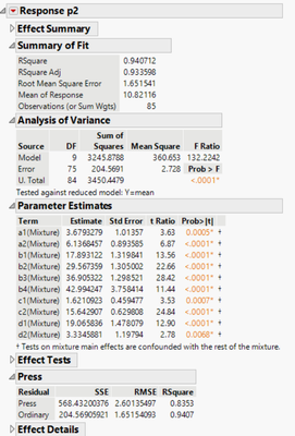

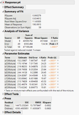

I analyzed both responses by just using a main effects model. No cross terms at all, and here are my results:
The model for p2 does look pretty good, even without seeing the residual plots. Similarly, the model for p4 looks good. Again, I did not include the residual plots. Notice that I do not see the high standard deviation or the negative PRESS that you found.
Without seeing similar results to you, I am guessing we used very different models. I would further guess that the high standard deviation and negative PRESS that you saw are caused by your model overfitting the data. By specifying a model with too many terms in it, the fit on the observed data will be great, but it might be too good. In other words, the model fits the signal AND some of the noise. By fitting some of the noise, that will lead to the increased variance and the model will not fit new observations very well. Another indication of overfitting is a fairly large discrepancy between RSquare and Adjusted RSquare (which are not part of your analysis pictures). Overfitting is one reason why just looking for high RSquare values is not always the best thing.
That is my best guess on what is going on: too many model terms and that has caused overfitting. Take a look at your RSquare and Adjusted RSquare. They should be fairly close to each other, maybe within 0.07 or so (just a rough idea on how close is close). To correct the problem, try removing unnecessary model terms, especially the ones that are not supported by the data that was collected.

Oh, and one more thing that further supports my guesses is that there are several missing responses for the p4 response. That means that you will not be able to fit the same model for p4 as you did for p2.
