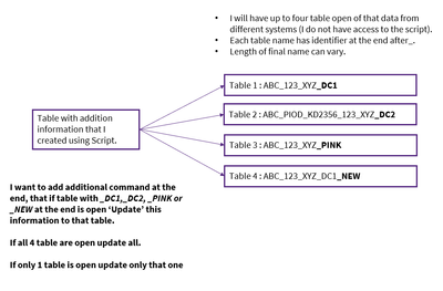

Re: Assign variable to table based on the contain of the table name.
I hope this will clarify further of what I am trying to achieve.
jthi
I don't think that provides any additional clarification to me, expect that you can capture the table "type" after last _. If you can capture table "type" from the end (after last _) you can use Associative Array (or still a list). You can use Word to capture the last part of name
