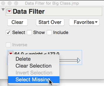

The best way to figure stuff like this out is to let JMP write it for you.
In the Data Filter there's a Select Missing option in the red triangle above a column.
Turn that on and then save the filter script to a script window to see how to script it.
Current Data Table() << Data Filter(
  Location( {838, -4} ),
  Add Filter( columns( :weight ), Display( :weight ), Select Missing( :weight ) )
