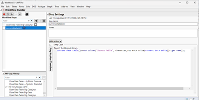

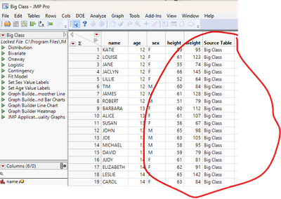

txnelson
Re: Create "Source Table" Column in Table that references Data Table Name
Here is a Work Flow step that can be added that adds the Source Table column to the current data table
Jim
kmprosperi
Level II
Thank you!! I am stepping away from standalone scripts & into the world of workflows!  This will be helpful!
