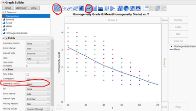

If you plot your data points, pressing SHIFT + clicking on the "Line" icon enable to superimpose these two graphical options :
You can have lines for several ID/formulations... if you add a new ID variable in the "Overlay" panel. Note that by default the line is a mean summary line, but you can change it into median, min/max, ...

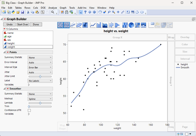

Then open Graph Builder and drag Height to the Y axis and Weight to the X axis.

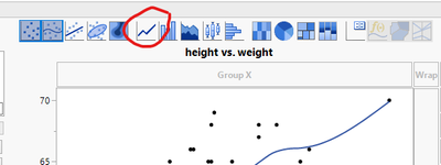

click on the Line icon

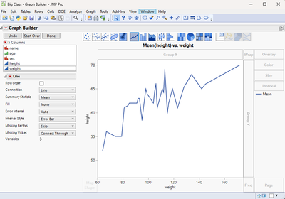

Which changes the display to

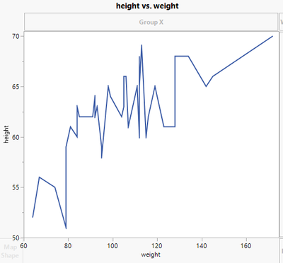

However, the line graph is graphing the mean values.  Th change to each data point select the Row Order box
