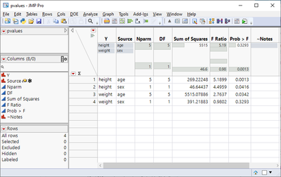

If I were to do something like this, I would most likely collect the results into JMP table, clean it if needed and save into desired format
Names Default To Here(1);
colnames = {"height", "weight"}; // many method of getting these
dt_result = Empty();
For Each({colname}, colnames,
	fm = dt << Fit Model(
		Y(Eval(colname)),
		Effects(:age, :sex),
		Personality(Standard Least Squares),
		Emphasis(Minimal Report),
		Run
	dt_p = Report(fm)[Outline Box("Effect Tests"), Table Box(1)] << Make Combined Data Table(Invisible);
	fm << close window;
	dt_p << Delete Scripts(dt_p << Get Table Script Names);
	If(Is Empty(dt_result),
		dt_result = dt_p;
		dt_result << Set Name("pvalues");
		dt_result << Concatenate(Append to first table, dt_p);
		Close(dt_p, no save);
dt_result << show window(1);
You could then save this into a .csv using (or save it as JMP table to make sure you don't lose any data in decimals)
dt_result << Save("$TEMP/test.csv");
