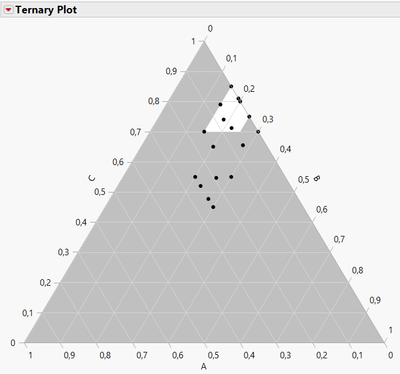

For your specific example, I created a D-optimal mixture design (for main effects and 2-factors interactions, 12 runs) respecting your constraints so that you can follow the steps.
The original design is created with this script :
DOE(
	Custom Design,
	{Add Response( Maximize, "Y", ., ., . ), Add Factor( Mixture, 0, 0.25, "A", 0 ),
	Add Factor( Mixture, 0.2, 0.3, "B", 0 ),
	Add Factor( Mixture, 0.45, 0.8, "C", 0 ), Set Random Seed( 324812 ),
	Number of Starts( 30462 ), Add Term( {1, 1} ), Add Term( {2, 1} ),
	Add Term( {3, 1} ), Add Term( {1, 1}, {2, 1} ), Add Term( {1, 1}, {3, 1} ),
	Add Term( {2, 1}, {3, 1} ), Set Sample Size( 12 ), Simulate Responses( 0 ),
	Save X Matrix( 0 ), Make Design}
If we check the experimental space with a Ternary plot, we can see that constraints are respected :

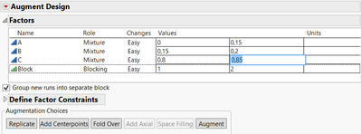

     1. From your design table, you can go in the menu "DOE", then "Augment Design". Specify your factors A, B, C and your response(s), and you should have this panel, where you can change the ranges of your factors with the new ones :

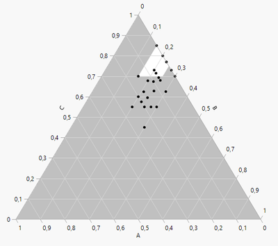

     2. Click on "Augment", specify the model assumed (main effects, 2-factors interactions, Scheffé Cubic ...) and specify a number of runs or leave the default one (you can try several augmented designs and compare them using the Evaluate Designs platform).
You now have an augmented design with new runs added in your newly defined experimental space that take into account previous information from the original runs.

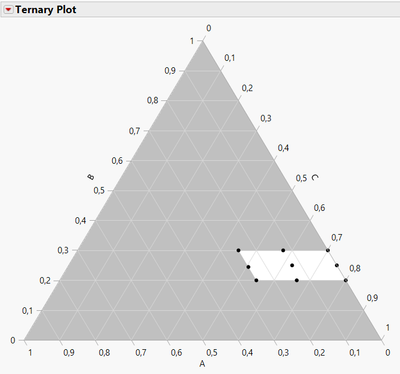

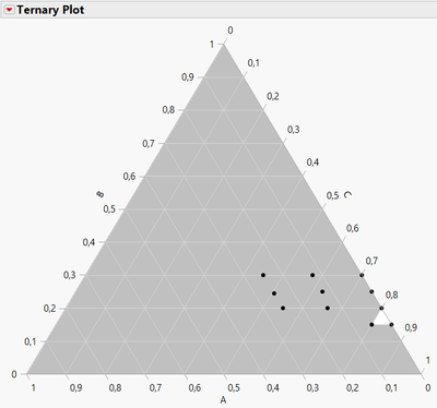

i seem to have overlooked one of your questions, the model assumed was the Scheffe cubic model. I chose D-Optimal design based on literature recommendations for mixture designs with constraints. I expanded the space to :
0=<A=<15
15=<B=<25
70=<C=<85
And my ternary diagram looks something like this :
