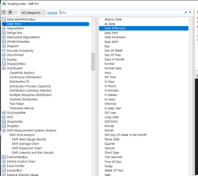

What is the problem you are having (translation in the community might be incorrect as I couldn't really find the issue easily)? Most likely you want to use Date Difference() or Date Increment(). Use "month" as intervalname and "start" as alignment to get the first date of month. For example first date of this month
Date Increment(Today(), "Month", 0, "start");
JMP also has Month() to get the month of date and many more datetime functions which you might find useful for this type of work
-Jarmo
