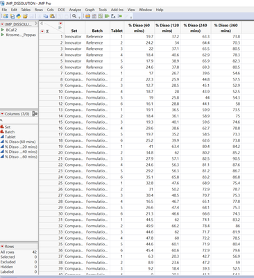

Step 1: Open JMP and Load the Data Table
Open JMP software.
Load your data table into JMP. Ensure your data is in the tall format with columns for Set, Batch, Tablet, Time (mins), and % Disso. If the data is not in the tall format, rearrange it using the Table menu functions in JMP.

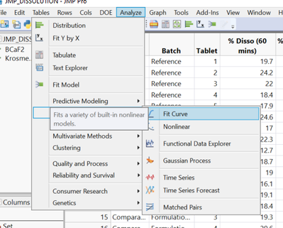

Step 2: Navigate to Fit Curve
In the JMP main menu, go to Analyze.
Select Specialized Modeling.
Click on Fit Curve.

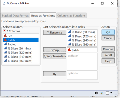

Step 3: Configure the Fit Curve Dialog Box
In the Fit Curve dialog box, choose Rows as Functions as seen in the screenshot below.
Select the columns for analysis:
Y, Response: Choose % Disso (60 mins), % Disso (120 mins), % Disso (240 mins), and % Disso (360 mins).
Group: Choose Batch.
Click OK to proceed.

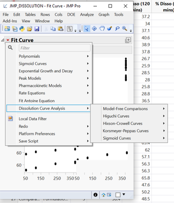

Step 4: Perform the Analysis
In the Fit Curve window, click on the red triangle menu next to Fit Curve to open the options.
Navigate to Dissolution curve Analysis.

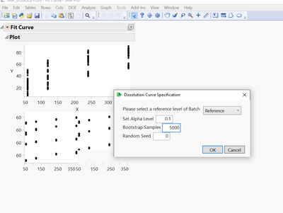

Select  Model-free comparisons F2 Analysis from the menu. This option performs a dissolution curve analysis using the F2 similarity factor, which measures the similarity of percent dissolution between the curves of the reference tablet and the curves of the test tablet.
The Dissolution Curve Specification dialog box allows you to configure important parameters for the F2 analysis, including the reference batch, significance level, number of bootstrap samples, and random seed.
