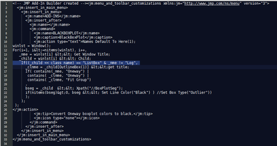

Thank you for providing such solution but for me after adding the Add-in when I try using this in my variability plot it throws alert "Cannot subscript Display box in access or evaluation of '_child [OutlineBox(1)]' ". Any solution do you have?

Most likely it is finding some other window it isn't supposed to (these might have changed in newer version of JMP). For me it did find "Log" window (enchanced log?) which caused the issue so I added check for "Log" window name:
Names Default To Here(1);
fit = dt << Oneway(Y(:height), X(:sex), Box Plots(1));
winlst = Get Window List();
For(i = 1, i <= N Items(winlst), i++,
	_nme = winlst[i] << Get Window Title;
	_child = winlst[i] << Child;
	If((_child << class name) == "ListBox" & _nme != "Log",
		_clnme = _child[Outline Box(1)] << get title;
		If(Contains(_nme, "Oneway") | Contains(_clnme, "Oneway") | Contains(_clnme, "Fit Group"),
			bseg = _child << Xpath("//BoxPlotSeg");
			If(N Items(bseg) > 0,
				bseg << Set Line Color("Black")
			)//Set Box Type("Outlier"))
You could edit the addin's addin.jmpcust file (found from %appdata%\SAS\JMP\Addins\com.blackboxplot.addin) and add the same check I did or rebuild the addin from the installer and modify code there
