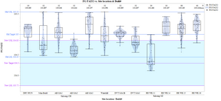

Is there any option to add Spec limits twice? for single dimension..
for ex., if any one dimension spec limit updated means the old comparion charts will be out-of-spec compared with new spec limits. i need to update it with both spec limits... any option is there without entering manualy using manage spec limits table.
the above chart i have updated manualy, but i need it for multiple dimensions...!
Anyone have idea on this?

To my knowledge you cannot have two Spec Limits column properties. Depending on what you are doing you do have options, here are some ideas:
  1. Use stacked/long table and have each limit be in it's own column. This allows you to fairly easily plot them in Graph Builder
  2. You can use Response limits to show additional lines in graph, but it might mess up with some platforms.
  3. Use Ref Lines/Graphic Script. This option will require scripting
These might give some ideas what you could do with scripting:Manage Response Limits and Action and Alert Limit Column Property

hi Jthi,
thank you for your response. your tips helpful to me. once again thank u...
