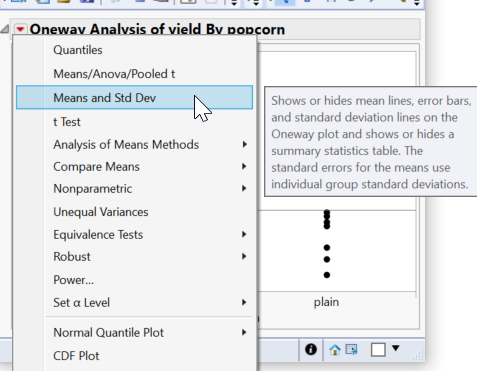

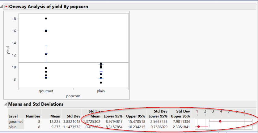

Hello,
The JMP17 Fit Y by X, "Means and Std Dev" output report changed the standard columns output.
I know how to change the displayed columns by right-clicking on the table and choosing the Columns I want to see.
I don't know how to make this a permanent preference for when I do this again on other data files.  I checked Preferences but, couldn't find where to change this.  Could someone please advise me on what to do?
I appreciate the additional available columns, but I don't want this output to be my standard.  I've had two other engineers here in my company ask me for help to make this preference change as well.
2023-02-21 16_03_37-Popcorn - Fit Y by X of yield by popcorn - JMP.png2023-02-21 16_03_56-Popcorn - Fit Y by X of yield by popcorn - JMP.png

Thanks Peter for helping.  As we discussed just now on the phone, we were not able to change the Preferences on this table using this method.
I was able to change the Columns in the table, and when I Redo Analysis the same Columns were selected.  But, I was not able to change my Preferences.  I'll add an item to the Wish List to be able to select Columns from the Fit Y by X Means and Std Dev.  Thank you
