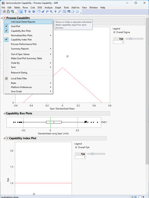

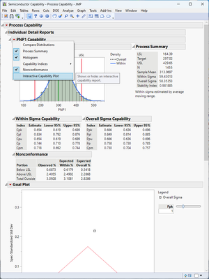

If you mean the Interactive Capability Plot, it was added in JMP 15.  Just run a Process Capability and open the red triangle menu.
*edit*
You'll have to have the Individual Detail Reports on for this option to come up.
