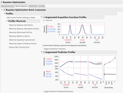

Once you have set or modified the desirabilities of your responses, you can use the option "Save Desirabilities" in the red triangle next to Augmented Prediction Profiler (or next to any Profiler):
  • Original situation with desirabilities :
    The run added using the default "Max Expected Improvement" has these factor values:
  • If I change the desirability  of MODULUS to minimize it, then Save Desirabilities, and relaunch the platform with the same settings:
    the default added run has changed:
So to answer completely your question, changing desirabilities will not change the candidate set created to rank the points to test in next iterations, but it will change the ranking and selection of points as it will be linked to acquisition function and desirability functions.
