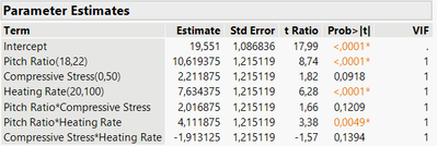

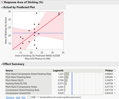

I have a 2-level full factorial design with 3 variables and with 2 center points. I considered 2 replicates and therefore, totally 20 runs. I made the data table with DOE > Classical > Full factorial design. For analyzing my data: Analyze > Fit model, Personality: Standard Least Squares, Emphasis: Effect Screening. My purpose was to know if my variables are fitted in a linear model or non-linear model? Because in Minitab, I think using "Analysis of Variance", the "quadratic term" shows if it is significance or not. I tried different Macros is JMP, but no one shows any sign of linearity or non-linearity as I knew.
JMP, Version 17.2.0 (701896)
Kindly I attached screenshots of my data table and fit model.

I'm a bit surprised by the screenshot of your model fitting because with the data you provide I don't seem to have the same output :
It seems the statistical significance of the terms in the model is somehow reversed compared to what you obtained ? I am not able to find similar results as you have. Has the table changed between the file you send and the screenshot you send ?

  • As you have included replicated centre points and your model is not saturated, you are able to perform a Lack-Of-Fit test (as shown in your screenshot as well), to assess whether the model fits the data well. Both in your model and the one I find you can see that the p-value for this test is quite high, so there is not statistical significant evidence that your model is not adequate for the data you have collected. So there is no indication at this stage that you should add quadratic effect(s) in your model.

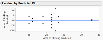

  • You can also take a look at residuals to see if you can spot some patterns. If a quadratic effect would be missing in the model, you can expect to see a curvilinear behaviour on the residuals. On your example, there is no obvious pattern :

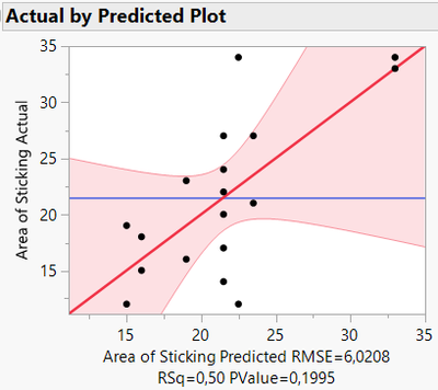

  • To also assess if your model seems to fit the data well, I would emphasize on the value of visualisations. For example, the "Actual vs. Predicted" plot (available under the red triangle, "Row Diagnostics", "Plot Actual by Predicted") offers a very easy way to assess the relevance of your model :
    Depending on the repartition of your point around the line of fit and the confidence intervals, you can assess the relevance and significance of the model : Effect Leverage Plots (jmp.com)

  • Linear relationship between variables and response : Looking at the "Residual by Predicted Plot", there is no obvious pattern showing a non-linearity in the residuals (constant variance, approximately normally distributed (with a mean of zero), and independent of one another) :
  • Normal distribution of errors : You can also check normality of the residuals with the plot Residual Normal Quantile Plot (accessible through red triangle, "Row Diagnostics", "Plot Residuals by Normal Quantiles"). Again, you don't have in your example an obvious pattern or strong deviation from normal :
  • Homoscedasticity of errors : You can check this assumption with the "Residual by Predicted Plot" seen earlier. In your case, there is no evident sign of heteroscedasticity.

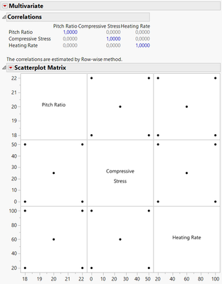

  • Independence of the observations : There might be several ways to check for correlations or multicollinearity in your data. You can use the platform Multivariate (accessible in menu Analyze, Multivariate Methods, Multivariate) to check if you have correlations between your factors. As your data was generated by a DoE without any constraints or covariables, you have perfectly independent factors without any correlations :
    You can also check multicollinearity by displaying Variance Inflation Factor (VIF) of the terms in your model : go into the "Parameter Estimates" panel, right click on the table displaying results, click on "Columns", and then choose "VIF". High VIFs indicate a collinearity issue among the terms in the model. While multicollinearity does not reduce a model's overall predictive power, it can produce estimates of the regression coefficients that are not statistically significant, as the inputs are not independent. In your case, nothing to worry about, VIFs are equal to 1, so effect terms are not correlated :
