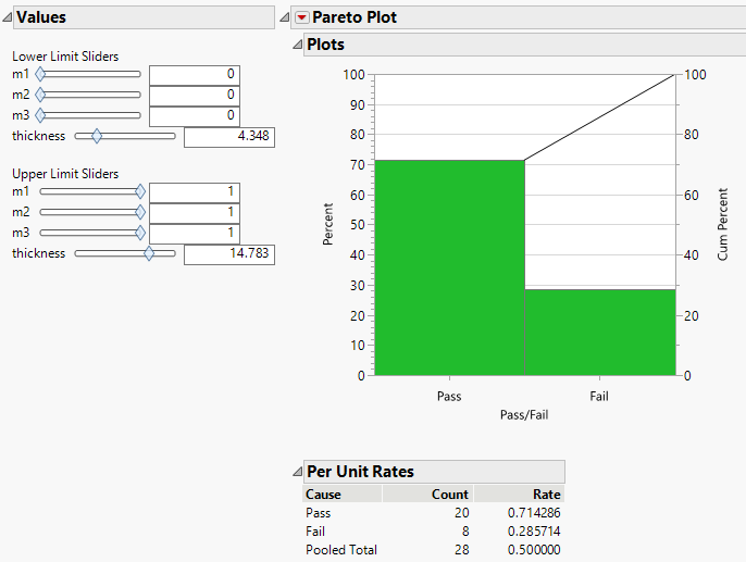

Creating an Interactive Pareto Plot with interactive Slider Boxes to update column formula
I have a set of specifications that a product in production would need to pass. I have a column with a formula that specifies the values needed (Limits) by each specification, and creates a binary pass/fail. This formula is used to create a Pareto Graph of passing number and percentage. I want to create an interactive Pareto Graph with slider boxes to adjust the testing limits, and see how changing these limits would change the amount of items passing/failing the test.
My main two problems are as follows:
1) There are multiple product types that will be tested. I wont have a consistent number of specifications per product, so I plan on inserting these specs into an list,(in the code attached that would be "spec") and using an external data table to fill in those specs for the desired product. This isn't something I need help with, but is something to consider as I will have to input slider boxes, number boxes, and so on in a for loop without directly referencing the variables.
2) I need an array of variables (spec limits) so that I can update the formula for testing purposes. Again this will need to be in a for loop. As the script stands right now, it appears the values of spec limits are not updating the in the formula for the pass/fail column. When the slider box receives the <<  inval command and the graph refreshes, nothing is happening as the actual pass/fail column isn't updated. I'm currently using an associative array to store the spec limits. This may not be the correct way to do this.
I have attached the sample data table I am using as well as the current script. Thanks!

jthi
Re: Creating an Interactive Pareto Plot with interactive Slider Boxes to update column formula
Code is fairly heavily modified and I'm not 100% sure how reliable this will be, but I would use set function and child/sib/parent to get correct references related to the slider boxes. Also pareto seems to get updated when formula value updates. This might benefit from some usage of Eval(EvalExpr())

jthi
I would use Range Slider Box, but it seems to be not working properly with associative array and list as fourth argument (I will send email to support tomorrow about this). So I would go back to Slider boxes.
This is now using formula expression and double slider boxes (it is fairly easy to break scripts like this which depend on variable names in windows, so you might have to add namespaces or something else for those)

Example of the issue:

JMewborn
Level II
Thank you so much! This is my second week scripting in JSL and you have no idea how much you helped me.

JMewborn
Level II
I very much appreciate the help you have given over the past few days. I have been working through your solutions to this as well as my other post,Having a column formula update based on a associative array referenced by a list.
I've looked through and tried to work out the parse and eval expressions and am getting an understanding of how that works in jsl. I am having an issue with combining the two Ideas. I realized that it would be better to have 4 indices in the associative array to store specs.In the format  "spec" => {<Lowest allowed tolerance>, <Lower Limit of spec>, <higher limit of spec>, <Maximum allowed tolerance>}. Thanks to your help with the parsing, the script below now creates this array and a Pass/Fail column to see if all specs are met. The goal being to loosen tolerances in the limits, up to lowest or maximum tolerances in order to obtain the new desired passing yield rate of product, and updating the pareto chart as you fixed above. I have tried implementing a range slider box, as this would be more intuitive for relaxing tolerances on limits, but am having trouble. It also breaks the pareto plot auto updating as before.
I believe one problem might be that because "f" string is being defined initially, I do not think that it will update for future executions of setting the formula for the pass fail column. Any way you might be able to help would be greatly appreciated.
Names Default To Here(1);
