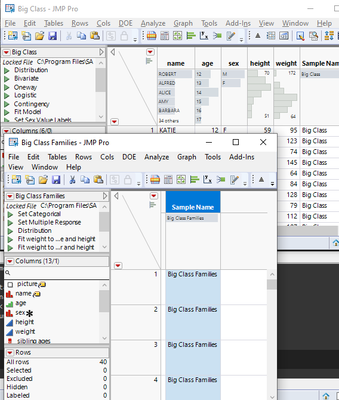

Do you want to add new column to each of the tables named "Sample Name" and it will contain only the name of that specific data table?
Names Default To Here(1);
Open("$SAMPLE_DATA/Big Class.jmp"); // open for demo purposes
Open("$SAMPLE_DATA/Big Class Families.jmp"); // open extra table for demo purposes
new_col_name = "Sample Name";
For Each({dt_cur}, Get Data Table List(),
	name = dt_cur << get name;
	If(!Contains(dt_cur << Get Column Names("String"), new_col_name),
		dt_cur << New Column(new_col_name, Character, Nominal, << Set Each Value(name));
-Jarmo

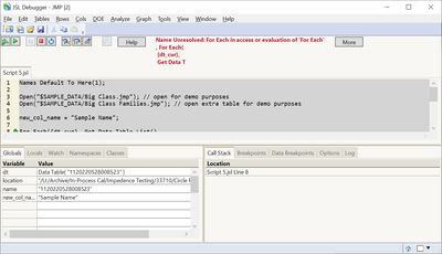

Thanks for your response.
I get an error when running this script
jthi
Re: How to add new column to all data tables
You are most likely using older version of JMP (For Each was introduced in JMP16). Simple fix is to replace it with For loop (also fixed one typo on the code):
dt_list = Get Data Table List();
For(i = 1, i <= N Items(dt_list), i++,
	dt_cur = dt_list[i];
-Jarmo
