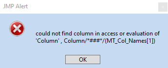

Hello,
This doesn't work for me when I use:
SubTable3[i] = Tables[i] << subset( selected rows(1), columns(Column(MT_Col_Names[1]), Column(MT_Col_Names[2]), Column(MT_Col_Names[3]), Column(MT_Col_Names[4]), Column(MT_Col_Names[5]), Column(MT_Col_Names[6])), Invisible);
The error is:
And if I change 'columns' to 'As columns', It works (no error), but all columns show up...
Thanks for any help,
Nir

I don't think its necessary for you to enumerate all the items you have in MT_Col_Names or to wrap those in Column().  What type of data is inside "MT_Col_Names"?
Here's a working example with a list of strings representing the names of the columns I want to keep:
dt << Select Rows({1,2,3});
sub_cols = {"name", "age", "sex"}; //same role as MT_Col_Names
dt2 = dt << Subset(selected rows(1), columns(sub_cols));
-- Cameron Willden

Maybe try
eval(evalexpr((
As Column(expr(MT_Col_Names[1])), As Column(expr(MT_Col_Names[2])) ), Invisible);
jj_jmp
Level II
Re: Creating a subset of data based on a list of columns
eval(evalexpr(
