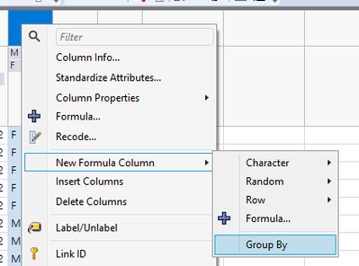

The Group By column is added to the column name:

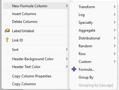

The current GroupBy columns are listed at the bottom of the New Formula Column Menu:

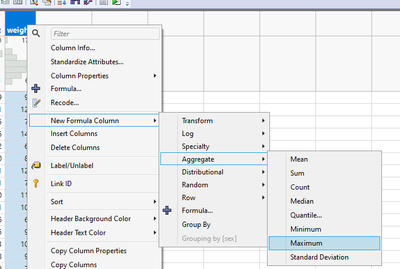

Re: Creating a new colunm with max values of another column for each month
Group By and Maximum quick formula should work
If this doesn't work, are your months really string months or are they formatted dates (in which case you might have to perform extra steps)?
Bug thanks Jarmo!! Two reasons why it did not work for me: Indeed, the date format (big kudos for detecting it) and the fact that "group by" was selected on the wrong column.
Side question: When formula is active, we have a big cross appearing close to the column name. What about "group by'? Any hint if a column was selected as "group by"? I feel it's critical to let the user know that this is on and on which column.  thx!! _Jm
jthi
Easiest way is to view the formula but you could add Notes property yourself to such columns. If you wish to have something new in JMP, make a new post to JMP Wish List
