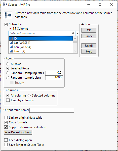

I have a big dataset with more than 3 million rows. The table contains 1105 ID (0-1104). Each ID has 3287 rows. So, I want to create 3287 subsets, and each subset contains 1105 ID lines.
Could you please help me to find the solution?
I attached the part of the dataset.

If you have lots of memory, all you have to do is to select the Subset By check box, and to select id
Another method would be to save the subsets as they are created.   This will allow the method to run without having to use up a lot of memory.
