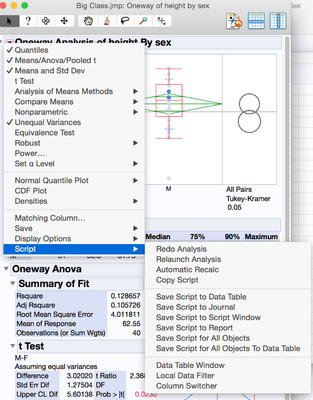

Have you used the red triangle>Script>Save Script to Journal?

Hi LouV,
I just tried this out. I end up with a link to the graph in the journal window - which is interactive. But because I will have several graphs as output for the user, I'd prefer to have the actual graphs together housed in the same journal window. However, this may be a workaround solution.
