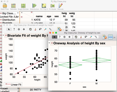

First open up all the graphs you want to link.
Here we just opened up a couple of graphs for the Big Class help sample data set that LouV was using.

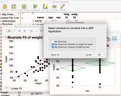

Next use the combine windows command to pull all the graphs into one window.
Here is the Mac version below...the PC version of this can be done straight off the Home Window.

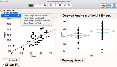

Then save the window script back to the Journal.

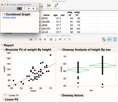

Then you have the interactive link on the journal!
Note that combining windows is the fast way to orient graphs within the same window.
