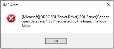

I'm trying to establish connection to database through scripting and it's the first time I'm doing this. I was able to create the following script but it seems that there's a bug that everytime there's unsuccessful connection, there's a default "JMP Alert" pop-up (see snapshot) instead of being contained within the "Try" function (I was trying with an incorrect database name of "TEST" which led to the pop-up. Is there a way to control this ?

Try some variation of this.
bi = Batch Interactive( 1 );
Try(
    db = Create Database Connection( DB.SQL_Updated );
    If( Is Missing( db ),
        Print( "unable..." ) // I think this is the right way to notice the error
    Print( "Unable to connect to Database" ) // I think this may not happen?
Batch Interactive( bi );
You can use logcapture() if the log message is an issue.
I think using the returned value from the first batchinteractive call to pass to the second is the right way to push/pop the flag. I think JMP is internally pushing "interactive" for the flag when a script is run from a button.

Thanks @Craige_Hales. I don't understand what exactly "Batch Interactive ()" does, but it solves the issue. :D

Ah, sorry, left that out. If JMP believes it is running in Batch mode (ancient terminology about batch processing data, without a terminal for user input) then those alerts are written to the log and a default response is made. Otherwise, in Interactive mode, JMP opens a modal dialog to get the response. Most of the time, if a button was pressed to start some JSL, the interactive behavior is correct. And if a script is submitted (over lunch perhaps) you'd rather not come back to an "ok?" dialog. Button scripts tend to be short, so the heuristic tends to work.
