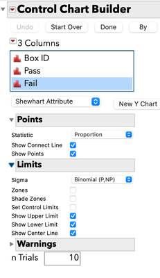

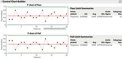

Its important to note that we aren't looking a capability of an attribute anymore, but a variable, which is percent defects.
It might still be a really good idea to run a P, C, or U chart along with this data.
