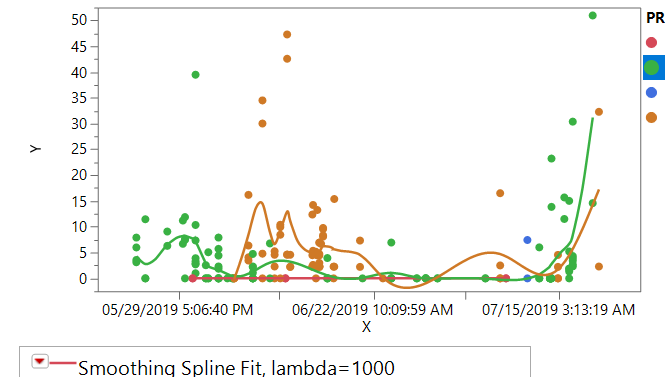

How can I make unselected line faded (such as fit line), similar to unselected marker faded?

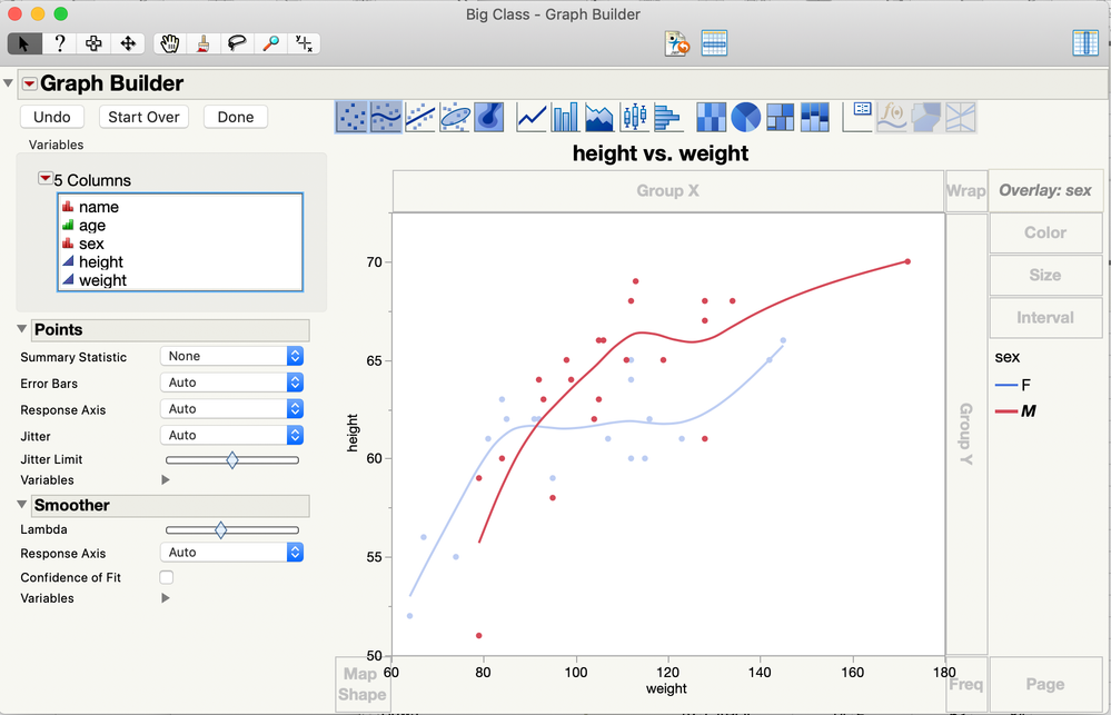

Graph Builder in JMP 14 does that by default.

Thanks! Actually, it is for fit lines. For example, in Fit Y by X, after group the data, doing fit lines for each group. How the unselected line be faded?

Unfortunately, Fit Y by X doesn't support line selection. What you've selected is only the label in the legend.
Fortunately, as I showed above the same graph can be created in Graph Builder where the line is selectable.
If you'd like for lines to be selectable in the Fit Y by X platform, be sure to enter a suggestion in the JMP Wish List.
