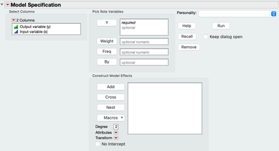

At first I thought of using “Fit model platform” and then displaying Spearman’s coefficient, but then I found this information in a JMP book:

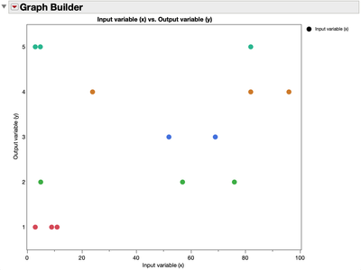

According to this table, when dealing with an ordinal response variable and a continuous predictive variable, I should work with ordinal logistic. I conducted this in the “Fit model” platform and it gave me these results (script present in the file attached):
I had to go through several sources of JMP documentation and videos to try to understand these results. I found a lot of sources, but most of the time they focused on nominal logistic cases and were too focused on describing each part of the report rather than on practical meaning and most useful information to get from this. My objective is not to have an in-depth understanding of the math/stats, but rather be very practical on what these results are telling me.
What I could understand (please correct me if I’m wrong) is that the value with the green circle in the figure above tells me that my model is not very good. For my case, using a single input variable, could I use this result to finally say that there is not any sort of correlation or association between my input and output variables ? > this is the main question I want to answer.

Your output (y) variable is very noisy if you were expecting the x to accurately predict your y. Level 5 of the y variable has two out of three x-values that look more like the x-values of when y=level 1, i.e. two level 5 results are associated with x-values of 3 and 4 making it look more like level 1 of your y-variable which has x-values of 9, 11, and 3. Levels 2 and 4 of your y-variable similarly span a wide range of x-values (from 5 to 76 for level 2 and from 24 to 96 for level 3). As your analysis confirms x is not a statistically significant predictor of y. Is there another potential input variable not yet measured that could be influencing your y-variable?
Your statement of how to interpret the prediction profiler for an ordinal logistic regression model is correct. But please refrain from trusting these predictions as x is not a significant predictor of y due to the excessive noise in the relationship.
