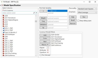

I am using the fit model function to model a continuous variable with 6 different categorical effects. However the DF listed for the model is given as 8 instead of 6 and the parameter estimates is breaking two of these categorical variables into two categories each. Why are these two variables being broken up into two categories? Are the degrees of freedom correct? I have include photos of the fit model screen and the parameter estimates screen. Thank you!

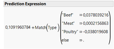

  • DFs in your model : The number of DFs "consumed" by your model depends on the type of factors you have. For example, each  numerical continuous factor uses 1 DF in the model to estimate the parameter in the equation. For categorical factor, the number of DFs used depends on the number of levels : For N levels in a categorical factor, the number of DFs used in the modeling is N-1, since the last level parameter estimate can be calculated from the others : in case of a 3-levels factor, the sum of the level estimates is L1+L2+L3 = 0.
    Example here with the equation of hot dog price depending on the type of meat, you can check that the sum of the 3-levels parameter estimates is indeed equal to 0:
Coming back to your topic, you seem to have the following factors in your model:
  • Q28: Gender : 2-levels categorical factor (representing 1 DF),
  • Q31: Hometown : 3-levels categorical factor (representing 2 DFs),
  • Q32: Highest Degree: 2-levels categorical factor (representing 1 DF),
  • Q39: EuthExp: 3-levels categorical factor (representing 2 DFs),
  • Q43: PriorTraining : 2-levels categorical factor (representing 1 DF),
  • Q44: Euth6mos : 2-levels categorical factor (representing 1 DF).
So the calculations in JMP are correct, you have in total 1+2+1+2+1+1 = 8 DFs used in your model, you had in your dataset 50 DFs available, so 42 DFs are left and used for error estimation, as seen in the "Analysis of Variance" panel.
