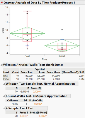

In the first case, besides using visualizations and Graph Builder, I think the platform Fit Y by X could help to see the differences between initial vs. final values for each products. Since you have low sample size with non normal distributions, I would suggest to use a non-parametric method for the comparison of means (Nonparametric Test Reports). Here is how the analysis would look like on Product 1 with a Wilcoxon test :
In this case, a statistically significant difference is detected between values initial and final for Product 1. To do this analysis, you'll need your data in a stacked format (Launch the Oneway Platform), see the datatable attached containing the script for this statistical test.
