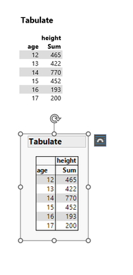

1. Select what you wish to copy from tabulate with selection tool
2. Right click and select copy
3. In word use paste options and paste as picture
or from
This way you should get into word as a picture instead of table (table above and picture below)

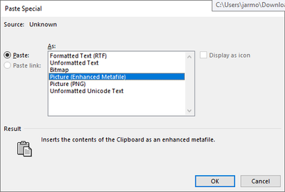

Edit:
One good option when using Word (or Powerpoint/excel) is to use Paste Special and Picture (Enhanced Metafile) option
