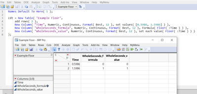

In addition to @txnelson , here's the code for it:
As you can see, you can uses a formula, or written values to that column.
It's better to avoid loops (for each row), if tables can do it without, if possible.
Names Default To Here( 1 );
cdt = New Table( "Example Floor",
	add rows( 2 ),
	New Column( "Time", Numeric, Continuous, Format( Best, 12 ), set values( [0.5986, 1.5986] ) ),
	New Column( "WholeSeconds_formula", Numeric, Continuous, Format( Best, 12 ), Formula( Floor( :Time ) ) ),
	New Column( "WholeSeconds_value", Numeric, Continuous, Format( Best, 12 ), set each value( Floor( :Time ) ) )
	add rows( 2 ),

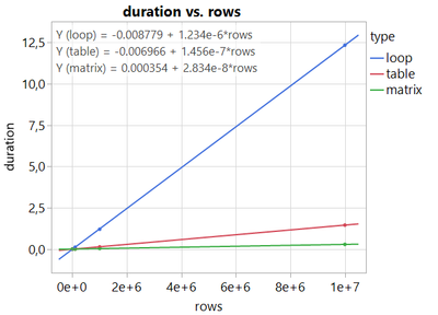

Dear @swanthog, in a script I tested out three different methods for calculating a square y = x*x in a table with different number of rows.
The outcome is,
  • that the loop takes ten times more time
  • as the table operation
  • and the matrix calculation is 5x faster than the table operation
Also in terms of clean code and less errors, it is in my opinion a good recommendation to avoid loops, if there are other methods (table and matrix), that have built in functionality to adress each element.
But for small scripts, and if performance is no issue, loops are also ok. Also readability (to the eyes of the writer) counts.
