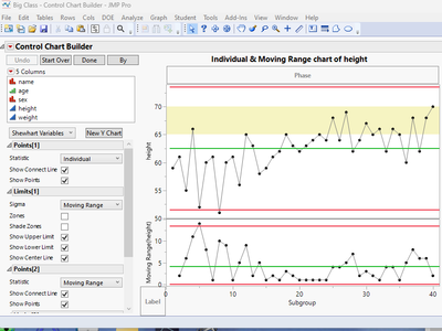

Reference Lines that have a range specified can be used to display colored areas.  Here is a simple example.
names default to here(1);
dt =
// Open Data Table: Big Class.jmp
// → Data Table( "Big Class" )
Open( "$SAMPLE_DATA/Big Class.jmp" );
ccb = Control Chart Builder(
	Variables( Y( :height ) )
ccbr = ccb << report;
ccbr[AxisBox(2)] << Add Ref Line( {65, 70}, "Solid", "Yellow", "", 1, 0.25 );
dt =

Using Send to Report() is not a good practice in scripting.
See this example of a variation of the reference line for an axis:
Names Default to Here( 1 );
ccb = dt << Control Chart Builder( Variables( Y( :weight ) ), Show Control Panel( 0 ) );
rpt = ccb << Report;
rpt[AxisBox(2)] << Add Ref Line( { 90, 100 }, "Solid", "Red" );
