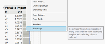

I'm not sure about this because I don't use PLS much. But you might want to try bootstrapping the VIP estimates in the Variable Importance table. In this way you can create bootstrap confidence intervals for each of the VIPs, which should be useful for hypothesis testing. The option is available in JMP Pro when you right-click on the table of VIP values (you get this table by selecting Variable Importance Plot from the red triangle menu for the model). I hope this helps.
