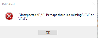

Is there a way of combining the running of a short script that updates the table variable when dragging the slider? I tried putting in the script in the Move-> Edit scripts under the Properties Window of the slider box
dt = Current Data Table();
dt << Set Table Variable("A"), mySlider );
with Variable Name mySlider, but when running the Application, I get the error image.png
when moving the slider, so I must be doing something wrong.
